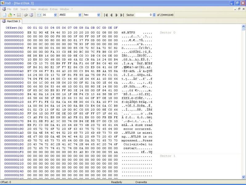

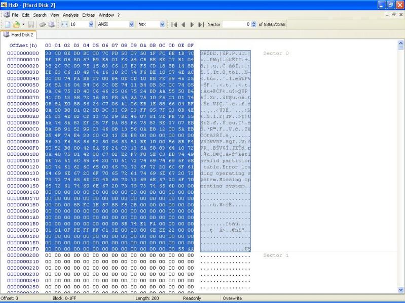

Provedeno, upnuto. Jen ještě - můj primární harddisk je s oddílem C:, mám ale v PC i druhý
harddisk - ten jsem si sám neformátoval, ale tam snad není... Vytáhl jsem dumpy i druhého disku, jsou ve složce, moc děkuji...

_______MBR \Device\Harddisk1\DR1
0x00000000 33 C0 8E D0 BC 00 7C FB 50 07 50 1F FC BE 1B 7C 3À.м.|ûP.P.ü¾.|
0x00000010 BF 1B 06 50 57 B9 E5 01 F3 A4 CB BE BE 07 B1 04 ¿..PW¹å.ó¤Ë¾¾.±.
0x00000020 38 2C 7C 09 75 15 83 C6 10 E2 F5 CD 18 8B 14 8B 8,|.u..Æ.âõÍ....
0x00000030 EE 83 C6 10 49 74 16 38 2C 74 F6 BE 10 07 4E AC î.Æ.It.8,tö¾..N¬
0x00000040 3C 00 74 FA BB 07 00 B4 0E CD 10 EB F2 89 46 25 <.tú»..´.Í.ëò.F%
0x00000050 96 8A 46 04 B4 06 3C 0E 74 11 B4 0B 3C 0C 74 05 ..F.´.<.t.´.<.t.
0x00000060 3A C4 75 2B 40 C6 46 25 06 75 24 BB AA 55 50 B4 :Äu+@ÆF%.u$»ªUP´
0x00000070 41 CD 13 58 72 16 81 FB 55 AA 75 10 F6 C1 01 74 AÍ.Xr..ûUªu.öÁ.t
0x00000080 0B 8A E0 88 56 24 C7 06 A1 06 EB 1E 88 66 04 BF ..à.V$Ç.¡.ë..f.¿
0x00000090 0A 00 B8 01 02 8B DC 33 C9 83 FF 05 7F 03 8B 4E ..¸...Ü3É......N
0x000000A0 25 03 4E 02 CD 13 72 29 BE 46 07 81 3E FE 7D 55 %.N.Í.r)¾F..>þ}U
0x000000B0 AA 74 5A 83 EF 05 7F DA 85 F6 75 83 BE 27 07 EB ªtZ.ï..Ú.öu.¾'.ë
0x000000C0 8A 98 91 52 99 03 46 08 13 56 0A E8 12 00 5A EB ...R..F..V.è..Zë
0x000000D0 D5 4F 74 E4 33 C0 CD 13 EB B8 00 00 00 00 00 00 ÕOtä3ÀÍ.ë¸......
0x000000E0 56 33 F6 56 56 52 50 06 53 51 BE 10 00 56 8B F4 V3öVVRP.SQ¾..V.ô
0x000000F0 50 52 B8 00 42 8A 56 24 CD 13 5A 58 8D 64 10 72 PR¸.B.V$Í.ZX.d.r
0x00000100 0A 40 75 01 42 80 C7 02 E2 F7 F8 5E C3 EB 74 49 .@u.B.Ç.â÷ø^ÃëtI
0x00000110 6E 76 61 6C 69 64 20 70 61 72 74 69 74 69 6F 6E nvalid partition
0x00000120 20 74 61 62 6C 65 00 45 72 72 6F 72 20 6C 6F 61 table.Error loa
0x00000130 64 69 6E 67 20 6F 70 65 72 61 74 69 6E 67 20 73 ding operating s
0x00000140 79 73 74 65 6D 00 4D 69 73 73 69 6E 67 20 6F 70 ystem.Missing op
0x00000150 65 72 61 74 69 6E 67 20 73 79 73 74 65 6D 00 00 erating system..
0x00000160 00 00 00 00 00 00 00 00 00 00 00 00 00 00 00 00 ................
0x00000170 00 00 00 00 00 00 00 00 00 00 00 00 00 00 00 00 ................
0x00000180 00 00 00 8B FC 1E 57 8B F5 CB 00 00 00 00 00 00 ....ü.W.õË......
0x00000190 00 00 00 00 00 00 00 00 00 00 00 00 00 00 00 00 ................
0x000001A0 00 00 00 00 00 00 00 00 00 00 00 00 00 00 00 00 ................
0x000001B0 00 00 00 00 00 00 00 00 5B 74 E1 FA 00 00 00 00 ........[táú....
0x000001C0 01 01 0F FE FF FF C1 3E 00 00 80 6E EE 22 00 00 ...þ..Á>...nî"..
0x000001D0 00 00 00 00 00 00 00 00 00 00 00 00 00 00 00 00 ................
0x000001E0 00 00 00 00 00 00 00 00 00 00 00 00 00 00 00 00 ................
0x000001F0 00 00 00 00 00 00 00 00 00 00 00 00 00 00 55 AA ..............Uª

Ještě dumpy:
- ziskej.zip
- (169.46 KiB) Staženo 54 x

Na starém disku byl před lety WIN XP SP1 a pak SP3. (od doby co existuje Sinoval a jiné rootkity neslouží jako systémový disk). Dosud jsem používal vždy jen XP.
Mám tam Daemon Tools, tedy ten atapi a taky
c:\windows\system32\drivers\sptd.sys který TDSSKiller hlásí je pravděpodobně od nich.
Mbr log přes příkaz "%userprofile%\plocha\mbr" -t -s
Dumpnuty a uplodovány sektory hlavního harddisku 976768065-8 (MBR hlásí 65, gmer 68).

Re: Backdoor.Win32.Sinowal i po placeném odvirování
Screenshot přiložen. Ten nový Cidox... mám nepříjemný pocit, že by s mým PC udělali to samé jako teď...štěstí v mé smůle je, že jsem nechytil nějakou extra novinku.
Možná bych ten poslední sektor (je to ten hlášený 976768065-8?) přepsal, nechci se dožít nepříjemného překvápka... Jdu to fixnout a nahrát logy...
Zde záloha HDD1 sektor 0
33 C0 8E D0 BC 00 7C FB 50 07 50 1F FC BE 1B 7C BF 1B 06 50 57 B9 E5 01 F3 A4 CB BE BE 07 B1 04 38 2C 7C 09 75 15 83 C6 10 E2 F5 CD 18 8B 14 8B EE 83 C6 10 49 74 16 38 2C 74 F6 BE 10 07 4E AC 3C 00 74 FA BB 07 00 B4 0E CD 10 EB F2 89 46 25 96 8A 46 04 B4 06 3C 0E 74 11 B4 0B 3C 0C 74 05 3A C4 75 2B 40 C6 46 25 06 75 24 BB AA 55 50 B4 41 CD 13 58 72 16 81 FB 55 AA 75 10 F6 C1 01 74 0B 8A E0 88 56 24 C7 06 A1 06 EB 1E 88 66 04 BF 0A 00 B8 01 02 8B DC 33 C9 83 FF 05 7F 03 8B 4E 25 03 4E 02 CD 13 72 29 BE 46 07 81 3E FE 7D 55 AA 74 5A 83 EF 05 7F DA 85 F6 75 83 BE 27 07 EB 8A 98 91 52 99 03 46 08 13 56 0A E8 12 00 5A EB D5 4F 74 E4 33 C0 CD 13 EB B8 00 00 00 00 00 00 56 33 F6 56 56 52 50 06 53 51 BE 10 00 56 8B F4 50 52 B8 00 42 8A 56 24 CD 13 5A 58 8D 64 10 72 0A 40 75 01 42 80 C7 02 E2 F7 F8 5E C3 EB 74 49 6E 76 61 6C 69 64 20 70 61 72 74 69 74 69 6F 6E 20 74 61 62 6C 65 00 45 72 72 6F 72 20 6C 6F 61 64 69 6E 67 20 6F 70 65 72 61 74 69 6E 67 20 73 79 73 74 65 6D 00 4D 69 73 73 69 6E 67 20 6F 70 65 72 61 74 69 6E 67 20 73 79 73 74 65 6D 00 00 00 00 00 00 00 00 00 00 00 00 00 00 00 00 00 00 00 00 00 00 00 00 00 00 00 00 00 00 00 00 00 00 00 00 00 8B FC 1E 57 8B F5 CB 00 00 00 00 00 00 00 00 00 00 00 00 00 00 00 00 00 00 00 00 00 00 00 00 00 00 00 00 00 00 00 00 00 00 00 00 00 00 00 00 00 00 00 00 00 00 5B 74 E1 FA 00 00 00 00 01 01 0F FE FF FF C1 3E 00 00 80 6E EE 22 00 00 00 00 00 00 00 00 00 00 00 00 00 00 00 00 00 00 00 00 00 00 00 00 00 00 00 00 00 00 00 00 00 00 00 00 00 00 00 00 00 00 00 00 00 00 00 00 55 AA- Přílohy
- Screenshot HxD Harddisk 2.JPG (105.75 KiB) Zobrazeno 1351 x
Fixnuto HDD1 sektor 0, HxD zkontrolováno - oo zapsány až po sektor 1B7, data bez újmy...

HDD0 sektor 0 tedy vyšel z testů jako čistý-netřeba zasahovat?... ESET Smart Security 5 nenachází na
C: a v bootech nic, 1 věc v Unlockeru 1.9.1.exe je BabylonToolbarApp.dll - varianta infiltrace Win32/Toolbar.Babylon - vím o tom, je v tom toolbar co stačí nenainstalovat a mělo by být čisté.
Nově stažený Kaspersky TDSSKiller - jen ten driver sptd jinak čisté. Přiloženy logy TDSKiller, gmer, mbr a mrrscan.
Gmer pořád hlásí: "\Device\Harddisk0\DR0 malicious Win32:MBRoot code @ sector 976768068"
mbr: "copy of MBR has been found in sector 976768065"
Vyřešilo by to odmazání těch sektorů? Servis - a to jsem jim za to platil!, chodím k nim přes 10 let, zatím to bylo ok, nicméně šikovní a vstřícní původní zaměstnanci jsou pryč a teď...
BTW zajímavá zelená kostřička...
