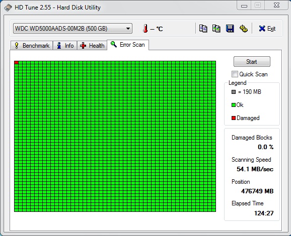

zde je screen -
- HdTune.jpg (165.25 KiB) Zobrazeno 1738 x

Coz o to, co si myslim ja, ale ani operacnimu systemu se disk zrovna dvakrat nelibi (Harddisk0\DR0 = disk C:\ )Slictyx napsal:chcete tedy říct že mě odchází HDD?
Disk samotny si dale shromazduje informace o svem stavu, ktere vypsala utilita CDI a tam take zrovna moc pozitivnich informaci nenieventvwr napsal:System errors:
Error: (03/14/2016 07:37:05 AM) (Source: Disk) (EventID: 7) (User: )
Description: Zařízení \Device\Harddisk0\DR0 má chybný blok.
Error: (03/14/2016 07:33:21 AM) (Source: Disk) (EventID: 7) (User: )
Error: (03/14/2016 07:33:18 AM) (Source: Disk) (EventID: 7) (User: )
Error: (03/14/2016 07:33:16 AM) (Source: Disk) (EventID: 7) (User: )
Error: (03/14/2016 07:33:13 AM) (Source: Disk) (EventID: 7) (User: )
Error: (03/14/2016 07:33:11 AM) (Source: Disk) (EventID: 7) (User: )
Error: (03/14/2016 07:33:08 AM) (Source: Disk) (EventID: 7) (User: )
Error: (03/14/2016 07:33:06 AM) (Source: Disk) (EventID: 7) (User: )
Error: (03/14/2016 07:33:03 AM) (Source: Disk) (EventID: 7) (User: )
Error: (03/14/2016 07:33:01 AM) (Source: Disk) (EventID: 7) (User: )
A posledni vec, co se tyka malwaru... mam podezreni na opatchovani knihovny C:\Windows\system32\User32.dll. Tady bude nutne instalacni CD (bojim se, ze budou opatchovany i zalohy ulozene na disku). Jiny malware v PC jiz nevidim.CDI napsal:Power On Hours : 19266 hod.
Health Status : Pozor
05 199 199 140 000000000002 Reallocated Sectors Count
C4 198 198 __0 000000000002 Reallocation Event Count
C5 200 200 __0 000000000005 Current Pending Sector Count
C6 200 200 __0 000000000007 Uncorrectable Sector Count
C8 200 200 __0 00000000000C Write Error Rate
