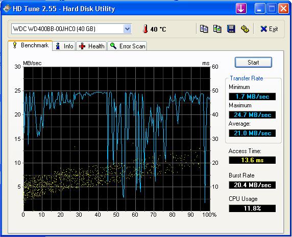

:arrow: Udelejte CDI dle kolegy
MiliNess napsal:Stáhni CrystalDiskInfo, v nabídce Úpravy zvol Kopírovat a obsah schránky sem vlož pomocí Ctrl+V.
:arrow: Otestujte HD pomoci HD Tune http://www.stahuj.centrum.cz/utility_a_ ... g/hd-tune/
  • Udelejte testy Benchmark a Error Scan - dejte screeny
  • Dejte screen ze zalozky Health
  • Scree udelate kdyz klilknete na tu modrou disketku a pak jej sem dejte dle tohoto navdou http://forum.viry.cz/viewtopic.php?f=11&t=14114 - zajima Vas jen cast "zaslani na forum" samozrejme :)

Tu je Crystal disk:
Date : 2013/10/09 20:23:12
+ VIA Bus Master IDE Controller [ATA]
+ Primary IDE Channel (0)
- SONY DVD-ROM DDU1621
- HL-DT-ST DVDRAM GSA-4163B
+ Secondary IDE Channel (1)
- WDC WD400BB-00JHC0
(1) WDC WD400BB-00JHC0 : 40,0 GB [0/1/0, pd1]
Model : WDC WD400BB-00JHC0
Firmware : 05.01C05
Serial Number : WD-WMAMC7666758
Disk Size : 40,0 GB (8,4/40,0/----)
Buffer Size : 2048 KB
Queue Depth : 1
# of Sectors : 78165360
Rotation Rate : Unknown
Interface : Parallel ATA
Major Version : ATA/ATAPI-6
Minor Version : ----
Transfer Mode : Ultra DMA/100
Power On Hours : 12068 hours
Power On Count : 2350 count
Temparature : 37 C (98 F)
Health Status : Caution
Features : S.M.A.R.T., AAM
APM Level : ----
AAM Level : 80FEh [OFF]
01 200 200 _51 00000000005B Read Error Rate
03 167 166 _21 000000000A5A Spin-Up Time
04 _98 _98 __0 000000000955 Start/Stop Count
05 200 200 140 000000000000 Reallocated Sectors Count
07 100 253 _51 000000000000 Seek Error Rate
09 _84 _84 __0 000000002F24 Power-On Hours
0A 100 100 _51 000000000000 Spin Retry Count
0B 100 100 _51 000000000000 Recalibration Retries
0C _98 _98 __0 00000000092E Power Cycle Count
C2 106 _91 __0 000000000025 Temperature
C4 200 200 __0 000000000000 Reallocation Event Count
C5 200 200 __0 000000000001 Current Pending Sector Count
C6 200 200 __0 000000000001 Uncorrectable Sector Count
C7 200 200 __0 000000000002 UltraDMA CRC Error Count
C8 200 200 _51 000000000001 Write Error Rate
000: 427A 3FFF C837 0010 0000 003F 003F 0000 0000 0000
010: 2020 2020 2057 442D 574D 4337 4337 3636 3637 3538
020: 0000 1000 0042 3035 2E30 3035 3035 5744 4320 5744
030: 3430 3042 422D 3030 4A48 2020 2020 2020 2020 2020
050: 4001 0000 0000 0007 3FFF 003F 003F FC10 00FB 0110
060: B570 04A8 0000 0007 0003 0078 0078 0078 0078 0000
070: 0000 0000 0000 0000 0000 0000 0000 0000 0000 0000
080: 007E 0000 346B 5B01 4003 1801 1801 4003 103F 0000
090: 0000 0000 FFFE 600B 80FE 0000 0000 0000 0000 0000
100: 0000 0000 0000 0000 0000 0000 0000 0000 0000 0000
120: 0000 0000 0000 0000 0000 0000 0000 0000 0009 0000
130: 0000 0000 0000 1253 0000 0000 0000 0000 0000 0000
200: 0000 0000 0000 0000 0000 003F 003F 0000 0000 0000
250: 0000 0000 0000 0000 0000 C6A5
Re: Divné chovanie PC
#29 Příspěvek od vyosek »
I log z CDI potvrzuje poskozeni disku...Disk je bohuzel zraly na zalohu dat a ekologickou likvidaci...

#30 Příspěvek od 7777 »
log
Bez názvu.JPG (66.91 KiB) Zobrazeno 1229 x
